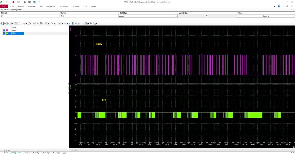

While debugging using multi-link, I am able to get interrupts during sleep periodically as configured. Below is the attached image.
Whereas when I removed the debugger after flashing the code and when I do Hard reset, during sleep I am unable to get interrupts periodically. Before entering it is becoming high and only after giving external interrupt (LIN) it is made as low. It means there is no interrupt happened in sleep. Below is the attached image.

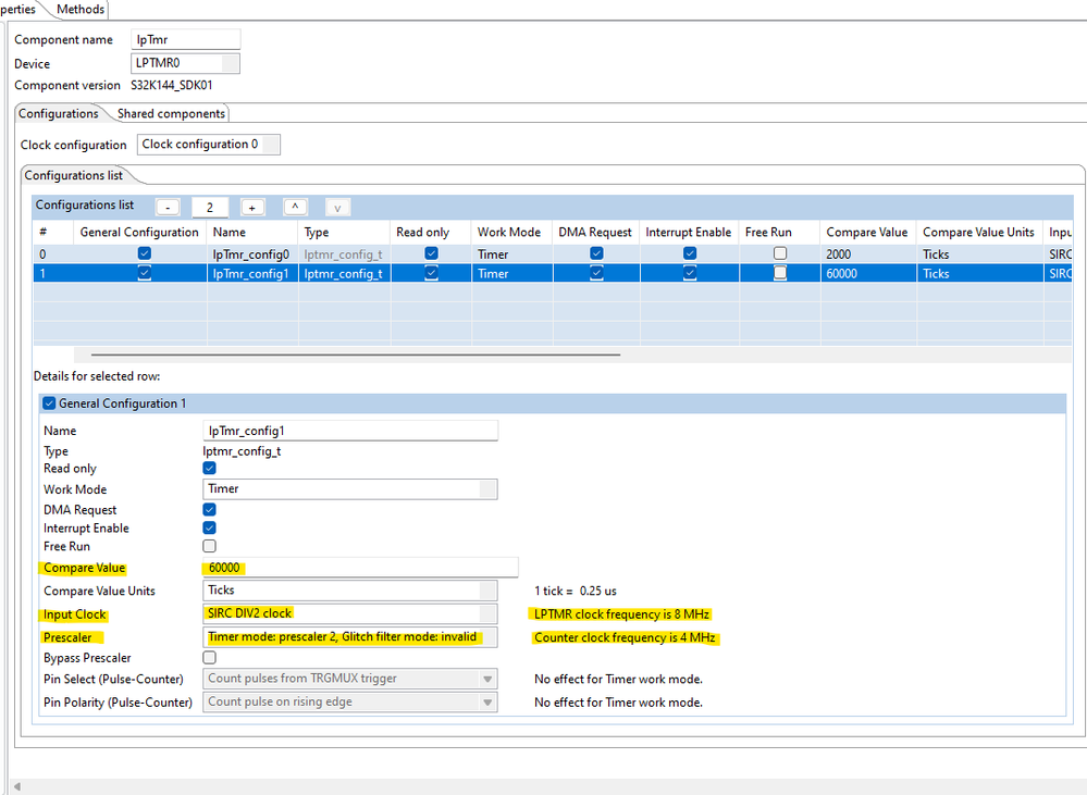

If I configured LPO(1KHz) clock before entering VLPR/VLPS mode. I am able to observe the interrupts periodically. Below is the attached image.
Below are the screenshots of LPTMR configuration with LPO clock and with SIRCDIV2 clock.
With LPO clock:
With SIRC DIV2 clock:

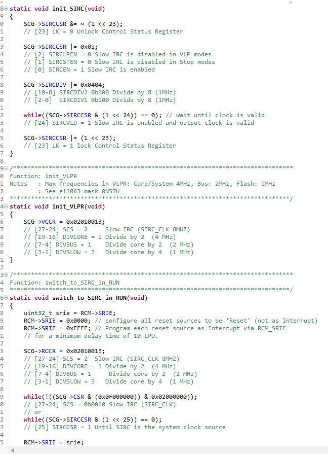

I have attached image below related to code implemented before controller goes to sleep.
In the above image, yellow highlighted indicates that configuring the new LPTMR configuration before entering VLPR. This is where I configured SIRC DIV2 clock instead of LPO clock.
Red highlighted indicates, RUN mode LPTMR configuration is de-initialized.
Blue highlighted indicates, entering VLPR mode.

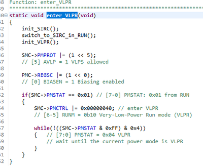

Below is the attached images of VLPR code.
Could you please check the configuration and suggest me if any changes are required either in code or in the LPTMR configuration.

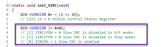

I have noticed that SIRC clock in VLPS is disabled in init_SIRC()
Can you double check the register?

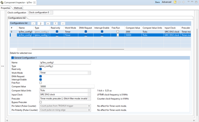

Has you suggested, I updated the changes related to SIRCCSR and also in VLPS mode bus clock is 4MHz and so at LPTMR component level I selected Prescalar has prescalar4_Glitch filter mode 2 clocks (I modified this change because you mentioned that SIRCDIV2 clock frequency should be less than Bus clock frequency.
Attached below is the image of Bus-clock frequency in VLPS mode.
After flashing the code, observed that at LPTMR component level pre-scalar change, my device is not responding after LIN wakeup.
Whereas if I select pre-scalar value to 2, glitch filter mode: invalid then device is responding after LIN wakeup.
Attached the image below and highlighted the related to code changes.

I already tried by modifying the Pre-scalar value of SIRC DIV2 clock.
1. I generated the configuration with pre-scalar value as "Timer mode: prescalar 2, Glitch filter mode: invalid". You can observe that Counter clock frequency is 4MHz.
 Observations: The controller is not waking up periodically. But once LIN wakeup is given the controller is getting wokeup and data is transmitting.
2. I generated the configuration with pre-scalar value as "Timer mode: prescalar 4, Glitch filter mode: invalid". You can observe that Counter clock frequency is 2MHz.
 Observations: The controller is not waking up periodically. But once LIN wakeup is given the controller is not getting wokeup and not transmitting data.
In your last reply you mentioned that SIRC DIV2 clock frequency should be less than or equal to 4MHz. So, in above two conditions you can see that the counter clock frequency is less than or equal to 4MHz.
