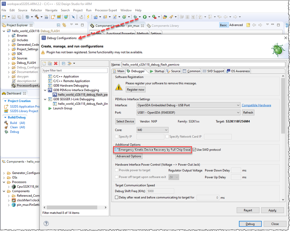

My PEMicro Interface can not debug because of my wrong configuration using MCAL port module without jtag pins, so I want to use MDS flash programmer to update new flash image, I build the hello_world_s32K118 and get the hello_world_s32k118.srec image, but when I copy the .srec file to S32K118EVB driver, the led is 2s off followed by 8 rapid on/off blinks, the state "error 7" in LASTSTAT.TXT file, If update MSD-DEBUG-S32K118EVB-Q064_Pemicro_v123.SDA file in bootloader mode, the state "completed" in LASTASTA.TXT file, so where is wrong, can you give me some advice? thans very much.

Hi Qiuju.ye,
"Emergency Kinetis Device Recovery by Full Chip Erase" in S32DS debug configuration window may helps.
If still not work, then please try to use the P&E recovery utility mentioned in Bricking and Recovering FRDM-KL25Z Boards: Reset, SWD Clock and Low Power . This tool is able to keep the board halted modem then you can use S32DS program or debug it.
