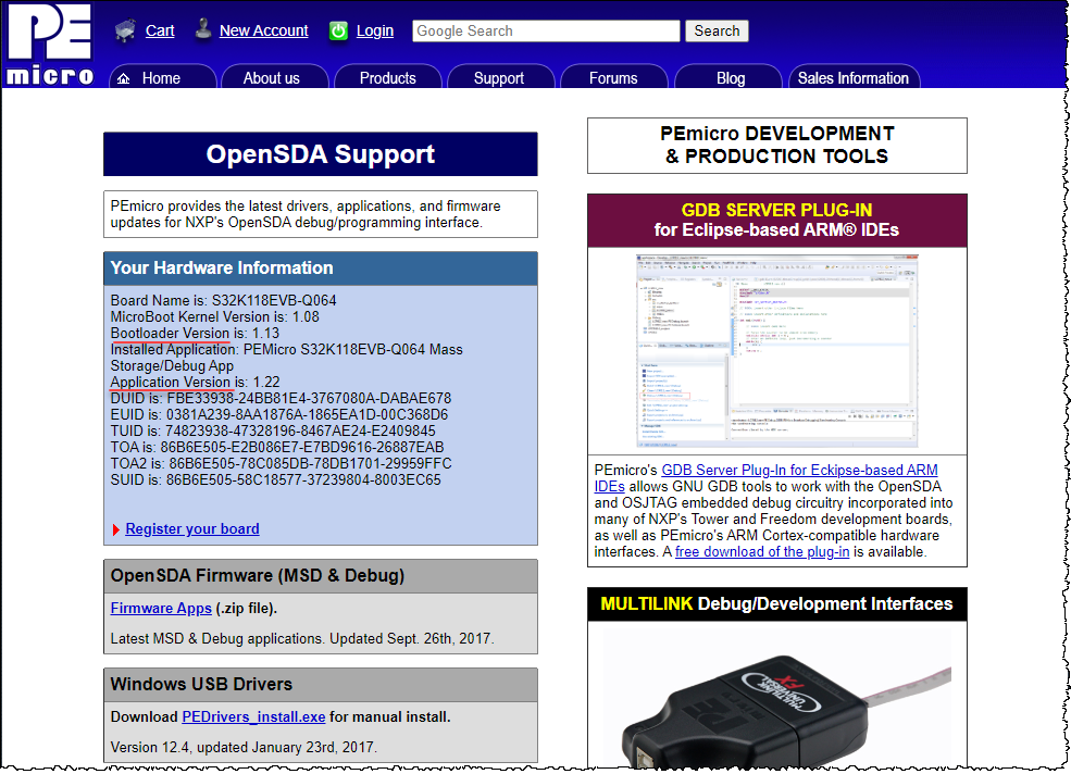

Robin_Shen
Hi Qiuju.ye,
Would you please click the "SDA_INFO" to check the information of OpenSDA?
Here is the information of my S32K118EVB.
Check the Bootloader Version and Application Version
The default Bootloader Version is 1.13, so I don't think you need to update it by using BOOTUPDATEAPP_Pemicro_v111.SDA.
I have try to update the Application Version to 1.23, it also work when debug S32K118 in S32DS for ARM2.2.
The J104 on S32K118EVB is connect pin 1 and pin 2. Keeping reset button SW5(RESET) pressed, while connecting the USB cable. It was able to get into bootloader mode. I just copy the MSD-DEBUG-S32K118EVB-Q064_Pemicro_v123.SDA into BOOTLOADER drive.
If you are using Win10 PC update firmware, then you may need to refer: Bricking and Recovering OpenSDA Boards in Windows 8 and 10
Robin
