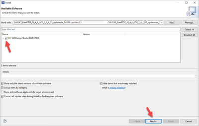

i have s32ds 3.5 and i'm using the board MCTPTX1AK324(and follow step provided to get started) with installation RTD 4.4 2.0.0,  IPCF 4.0.0.
I have tried to install sw32k3_FreeRTOS_10.4.6_2.0.0_D2204 and i following these steps on s32ds 3.5:
1)Open Window->Preferences. From next windows, select S32 Design Studio for S32 Platform-> S32DS Extensions and Updates, click Add All and select zip archive sw32k3_FreeRTOS_10.4.6_2.0.0_D2204
2)Help -> S32DS Extensions and Updates. At this point a window appears indicating unsuitable package(i have include image in the attachment) . The question is: which version of FreeRTOS should i download to be compatible with RTD 2.0.0 and s32ds3.5?
Thanks in advance for any help and info

Hi @michelet1
Could you validate if the following works for you?
You need to accept all the terms and conditions, and if the package is correctly installed S32DS will ask you to restart.

Thanks for the reply. I tried to follow the steps you indicated and i actually managed to install freertos.

Hello @VaneB,
anyway the installation of FreeRTOS on s32ds3.5 was successfull following your steps.
