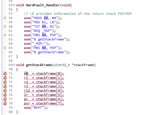

_simple_
I add these code into HardFault_Handler,but the translater report follow error:
Multiple markers at this line
- Symbol 'r0' could not be resolved
- 'r0' undeclared (first use in this function)
4,933 Views
danielmartynek
Symbols r0, r1 ... are variables and must be declared: uint32_t r0;
Also, the function getStackFrame should have a prototype.
