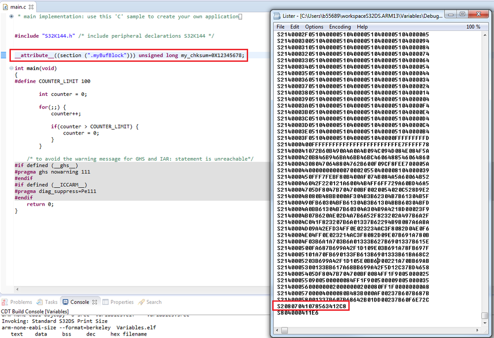

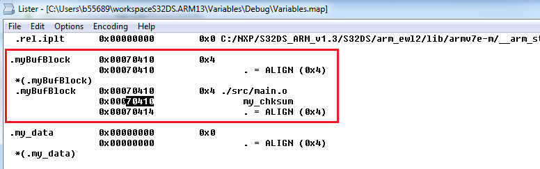

I used your code and works correct on my side. Please see figures below:
Here is map file:
I am attaching you the project I used.

I noticed that in your project you've selected the "S-RECORD" for the flash image .
this works for me too however when I select the "INTEL HEX" , it will place 0X 70410 at location 0x5064(as if 0x5064 is a pointer which points to location 0x70410 and yet this section shows correctly in the MAP file.
This is a bit strange. I've been googling this and can't find any answers. the  image of hex file is attached.
Keep in mind the Endianess of Intel vs. Motorola.
