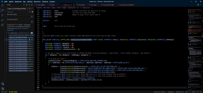

Nevermind, already checked solution on StackOverflow. Turned out, function that I've been using from CSE to loadkey uses low endian, when Crypto loadkey reverses it to big endian, making key invalid in process. Don't know if it version problems or something else but I think it's a bug somewhere
6,028 Views
RedOne
I think I found the issue, it's looks like that function Crypto_Cse_WritePagesToPRAM reversing endianess of key, making it invalid. How should I modify the code so it doesn't do this? Or should I modify input to be reversed already?

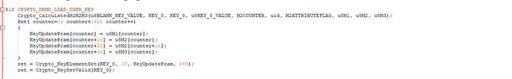

I'm afraid that I didn't get this function: crypto_loadKey. Did you mention Crypto_KeyElementSet?
Given that you have a user key as a 8-byte array. Because the M1M2M3 calculation functionality isn't available in the driver, you need to write it by your own (but I guess you've already had this function, since it's also required to load the master key), in order to convert the raw 8-byte data key to M1M2M3 format. After that, you will "append" the M1, M2 and M3 into an array, which will be used as the key data. Then you will pass the pointer to the key data to the Crypto_KeyElementSet() function.
Below is the snippet code:

6,108 Views
RedOne
In crypto_KeyElementSet there’s a function Crypto_Ipw_loadKey which passes keyptr further to crypto_cse_loadKey, which uses Crypto_cae_writePagesToPRAM in order to write key in to memory. This function returns key invalid error when I’m trying to point array of initial value of the key to it. So, as I understand from your answer I need to generate M1, M2 and M3, however I don’t understand the KeyUpdatePRAM function from your answer array. Can you elaborate what is it?
