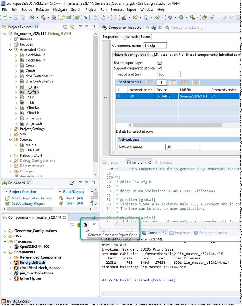

When I first opened the routine, all the.h files and.c files were missing. Some files were in the other routine and I could copy them over, but I couldn't find this one("lin_cfg.h"). What should I do? Why does this one not include the required.c and.h files while the other routines automatically include them?

Hi kalajiao,
If you are using S32DS ARM2.2, you will find the lin_cfg.h after click "Generate Processor Expert Code".
Robin
