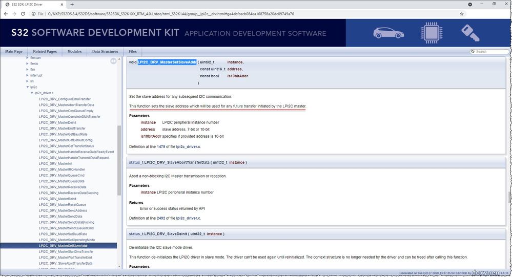

Hi Sai,
LPI2C_DRV_MasterSetSlaveAddr is used to sets the slave address.
For more detail please read the documentation <SDK_PATH>/doc/Start_Here.html
