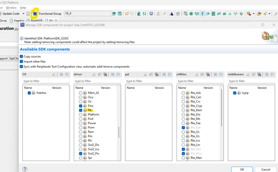

I'm currently using the S32K396 MCU with a raw TCP client implementation, which works fine. However, my module supplier requires me to switch to lwIP with FreeRTOS.
After importing the 'lwip_FreeRTOS_s32k396' example project and flashing it to my K396 board, the program enters the vPortEnterCritical() function when executing prvPortStartFirstTask(). How can I resolve this issues
S32DS versioln  3.5
RTD version 4.0
lwip version 1.0.4
freeRTOS version 4.0

Hello @zhangzhixing ,
I apologize for delayed response caused my workload.
The board was successfully brought up without any issues. However, a few minor adjustments to the project are necessary:
Peripherals > Pins: The TX_CLK signal did not have a specified direction — it has been set to Input. I also selected Fastest settings as the initial option.
Peripherals > Managed SDK Components: The Pins driver component was missing and has been added.
Clock settings: Configuration is correct — the FXOS 40 MHz clock matches the crystal used on the board.
PHY initialization: The call to Eth_T_InitPhys(); in device.c was commented out, as it is not required. The TJA1103 PHY relies solely on pin strapping for basic configuration.
I use TJA1103-SDBR board - TJA1103 needs to be in rev-RMII mode to generate clock on TXC -> added jumper 2-3 to CONFIG4
Update:
To improve behavior after power up, comment all rows with PIT in device.c (PIT is not used in this example):
// IntCtrl_Ip_InstallHandler(PIT0_IRQn, PIT_0_ISR, NULL_PTR);
// IntCtrl_Ip_SetPriority(PIT0_IRQn, 4);
// IntCtrl_Ip_EnableIrq(PIT0_IRQn)
// Pit_Ip_Init(PIT_INST, &PIT_0_InitConfig_PB_VS_0);
// Pit_Ip_InitChannel(PIT_INST, PIT_0_CH_0);
// Pit_Ip_EnableChannelInterrupt(PIT_INST, CH_0);
// PitPeriod = Clock_Ip_GetClockFrequency(PIT0_CLK) / 1000;
// Pit_Ip_StartChannel(PIT_INST, CH_0, PitPeriod);
Pavel
