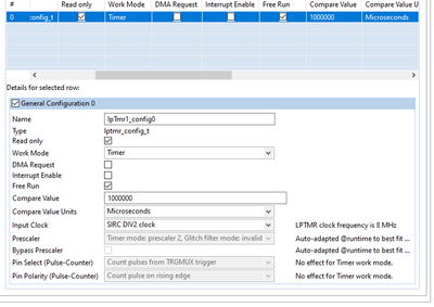

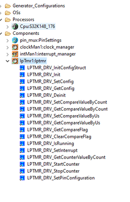

In lpTmr, using interrupt mode we can generate desired delay .
But i wanted to use free run mode to generate delay ,have a confusion which API functions do we need to use..
in below images i have attached the setting which i have done.
S32K148 EVB
SDK 3.0.0
thanks,

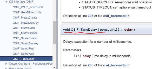

Senlent
Hi@dhirajtarole
I recommend you to use OSIF module,you can use the function OSIF_TimeDelay()
