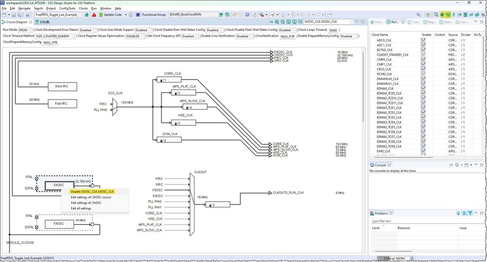

Hi NXP:
I tried to run FreeRTOS example on S32K312 platform, but it always be failed at exceptions.c file (HardFault_Handler function) finally,
and it looks like error about configuring the clock dividers that are under MCU control. Could you please tell me how debug this issue? thanks.

Have you modified FreeRTOS_Toggle_Led_Example_S32K312? I tested it on S32K312EVB-Q172 without HSE installed and there was no problem.
It is not recommended to use such an old version. The new version of RTD fixes many bugs. I noticed that the clock configuration in Clocks Tool does not match the "Table 152. Option B - Reduced Speed ​​mode (CORE_CLK @ 120 MHz)" of S32K3XXRM. This example incorrectly sets PLL_PHI0_CLK to 160MHz.
If there is no specific reason, we recommend using a newer version of the software.

In actually,I had modified MCU package from 172pin to 100pin for current project.
I also compared hardware of oscillator component between S32K312EVB-Q172 and current project are the same 16Mhz,
but I am not clear why MCU code always be failed at clock part.Does it have any ideas for checking?
Just now, I tried to modify PLL_PHI0_CLK speed from 160Mhz to 120Mhz,unfortunately the result is the same.
Could you please provide me about recommanding RTD driver version full name and download location? I can try again.

A3: Change the crystal pins in Pins Tool. Disable the 32.768kHz SXOSC:

updated status~~we found issue about HSE fw,because I took project board which including HSE fw inside MCU, so example code can't run. I changed new board and no HSE fw in MCU, it can works without issue.

If HSE FW is installed and S32K3 RTD 2.0.x is used, it is recommended to disable FIRC. Refer to this discussion: S32K3_HSE_BUG_RTD2.0.x
