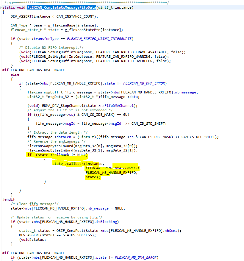

manujagrawal
Dear alexandrunan‌
We have faced a similar issue and trying to find a workaround as we cannot have a while loop to check EVENT_DMA_COMPLETE in our application.
After going through the driver's code, here is what I found:
FLEXCAN_CompleteRxMessageFifoData() is the function which calls the user callback on DMA completion and passes FLEXCAN_EVENT_DMA_COMPLETE as the event type to the user callback.
FLEXCAN_CompleteRxMessageFifoData() then returns to the parent function FLEXCAN_IRQHandlerRxFIFO() and after a few lines of code, the user callback is called again, but this time with FLEXCAN_EVENT_RXFIFO_COMPLETE event type. Hence, I assumed that at each RX_FIFO receive event with DMA, user callback will be called two times. After the user callback returns for the second time, FLEXCAN_IRQHandlerRxFIFO() function does not modify the status of the Rx MB Fifo as complete in accordance with the first message (it does that after the first call).
Therefore, I tried check for FLEXCAN_EVENT_RXFIFO_COMPLETE event instead of FLEXCAN_EVENT_DMA_COMPLETE in the event, like this:
But, but didn't get the second call of my callback. Practically, my callback was called only once with FLEXCAN_EVENT_DMA_COMPLETE after I ran the code. I tried with a breakpoint too at "RxFIFOdone = 1;", the code didn't stop.
Can you tell me if I am correct in my approach?
As a temporary fix (which works without while loop), I have modified the FLEXCAN_CompleteRxMessageFifoData() function by calling my callback again at the end with FLEXCAN_EVENT_RXFIFO_COMPLETE event; as shown in the image below.
Can the temporary fix be a permanent solution too? Or you can help me debug my first approach?
Thanks and Regards
Manuj Agrawal

alexandrunan
Hello Manuj,
First I need to know some details about this issue, what version of SDK release did you use ? Based on code snippets from pictures it looks like an previous code version from RTM 303.
Second we don't support driver modifications by customers only for special quotes and requested features.
cuongtranmanh‌, can you check if in last release is an issue mentioned by Manuj.
BR,
Alexandru Nan

manujagrawal
Hello alexandrunan‌
   I have been using SDK verion RTM 3.0.0 with came with update package 11 of S32DS-2018.R1
   Please do let me know an appropriate fix for avoiding the use of while loop with RxFIFO DMA.
   Also, is there a newer version of SDK available, if so, how do I obtain it?
