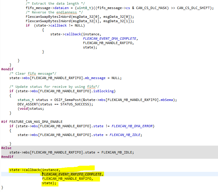

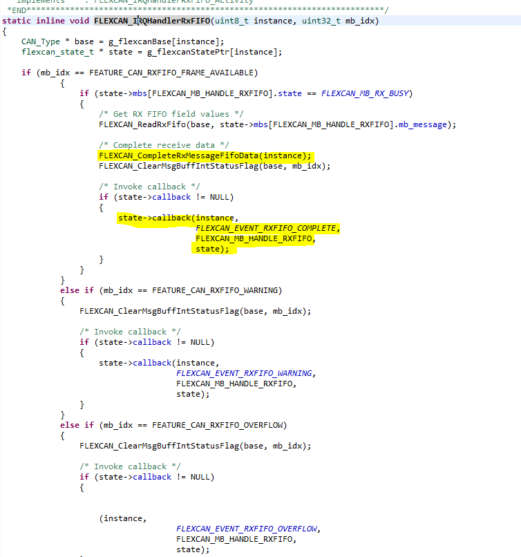

After going through the driver's code, here is what I found:
FLEXCAN_CompleteRxMessageFifoData() is the function which calls the user callback on DMA completion and passes FLEXCAN_EVENT_DMA_COMPLETE as the event type to the user callback.
FLEXCAN_CompleteRxMessageFifoData() then returns to the parent function FLEXCAN_IRQHandlerRxFIFO() and after a few lines of code, the user callback is called again, but this time with FLEXCAN_EVENT_RXFIFO_COMPLETE event type. Hence, I assumed that at each RX_FIFO receive event with DMA, user callback will be called two times. After the user callback returns for the second time, FLEXCAN_IRQHandlerRxFIFO() function does not modify the status of the Rx MB Fifo as complete in accordance with the first message (it does that after the first call).
Therefore, I tried check for FLEXCAN_EVENT_RXFIFO_COMPLETE event instead of FLEXCAN_EVENT_DMA_COMPLETE in the event, like this:
But, but didn't get the second call of my callback. Practically, my callback was called only once with FLEXCAN_EVENT_DMA_COMPLETE after I ran the code. I tried with a breakpoint too at "RxFIFOdone = 1;", the code didn't stop.
Can you tell me if I am correct in my approach?
As a temporary fix (which works without while loop), I have modified the FLEXCAN_CompleteRxMessageFifoData() function by calling my callback again at the end with FLEXCAN_EVENT_RXFIFO_COMPLETE event; as shown in the image below.
Can the temporary fix be a permanent solution too? Or you can help me debug my first approach?
