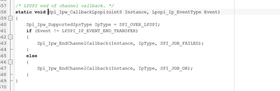

Anyway-- i'm not using Lpspi_Ip_AsyncTransmit() directly instead i'm using Spi_AsyncTransmit(). I stepped through the function-- i found Lpsi_Ip_AsyncTransmit() and Spi_Callback like this...
This all are auto generated code-- and neither i see any option to configure a spi callback function in EBT, so i have no control over this.

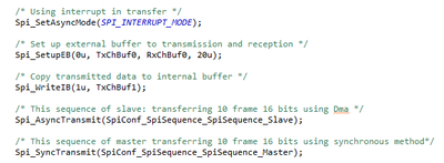

Hi @Guna,
When SPI interrupt mode, the asynchronous mechanism is ensured by interrupt, so interrupts
related to SPI buses handled asynchronously are enabled.
You can refer to Spi_Transfer_S32K344 example from the RTD package, which uses sync and async methods to transfer 16 bits using DMA:

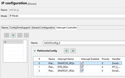

3. DMATCD IRQ should still be configured in the interrupt controller. Unfortunately, there are not many examples for SPI DMA, but please take a look into this RTD 3.0.0 S32DS example for the S32K312 derivative for some pointers in configuration: Example S32K312 SPI Transmit & Receive Using DMA DS3.5 RTD300 - NXP Community.
