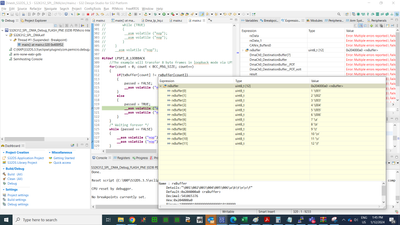

 The purpose of this demo application is to present a usage of the
 LPSPI IP Driver for the S32K3xx MCU.

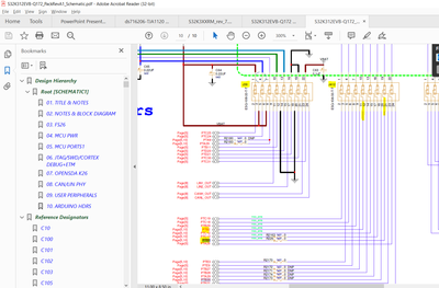

 The example uses LPSPI2 for transmit & receive Twelve bytes using the DMA.
MOSI MISO connected on Hardware in loopback.
* Test HW: S32K3X2EVB-Q172
* MCU: S32K312
* Compiler: S32DS3.5
* SDK release: RTD 3.0.0
* Debugger: PE micro
* Target: internal_FLASH
