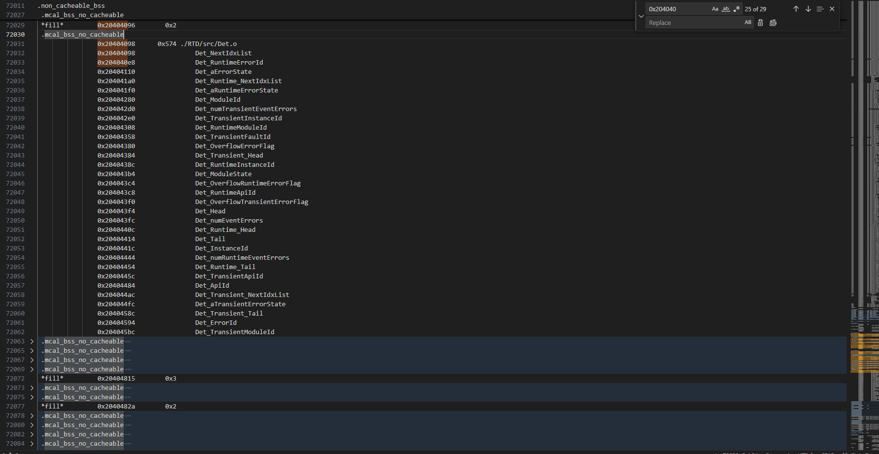

Hello @nxp ,
    I am using s32k31xevb and RTD 5.0 and i am configured ADC, CAN and PWM module, when I configure SPI module i am getting , 'non_cacheable_bss' will not fit in region 'int_sram_no_cacheable' error. region overflow by bytes 864.
  how to resolve this error? could you provide solution for this.

Hi @dhanabharathi,
Size of this section is defined in the linker file.
The int_sram_no_cacheable region is used for data that must stay consistent between the CPU and peripherals, such as DMA buffers. It avoids cache-related issues and ensures reliable memory access for real-time operations.
You could your linker file to allocate more space to the int_sram_no_cacheable region, however, you must make sure the new size does not overlap.
Also, if you are not using the Det module, you can simply delete it from project source directory to free up some space: Solved: S32DS Update RTD5.0 and Compile with non_cacheable_bss overflow error - NXP Community.

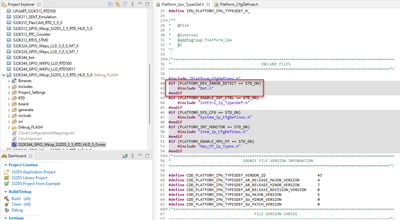

  1. if I remove Det.c file from RTD i am getting compilation error. I no need Det related (det.c) file how to handle this problem?

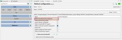

1. Are you deleting all related Det files? Have you disabled all of the error detection in your modules? If not, the driver may try to include related files:
2. Hard to say without seeing what you modified or where does the hard fault happened, however, please check the .map file compiled by your project, and adjust the link file according to the size of your program.
When adjusting the linker file, pay attention to MPU config and such. I suggest deleting Det.c for now to avoid overflow for now.

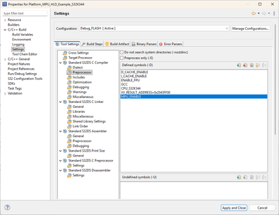

Julián_AragónM
Hi @dhanabharathi,
MPU can be disabled with Mpu_M7_Ip_Deinit().
Also, most examples have MPU_ENABLED defined as a project symbol:
This initializes the MPU inside SystemInit() function at startup. Keep in mind this removes memory protection, you should update MPU regions to match your linker changes instead of disabling it.
You can refer to ARM documentation:
