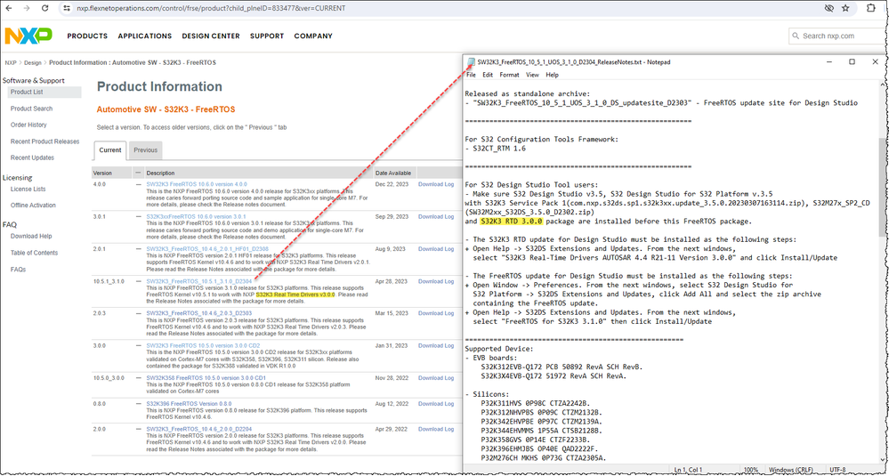

hi ,
i installed version RTS 3.00 for S32K344
and i have a failure when i want install package FREERTOS 3.00

I see that you installed S32K3 RTD 3.0.0, so it is recommended to install 10.5.1_3.1.0 SW32K3_FreeRTOS_10.5.1_3.1.0_D2304 offline. Refer to the offline installation method mentioned in HOWTO: offline install S32K3 RTD 3.0.0 in S32DS v3.5.
Robin
