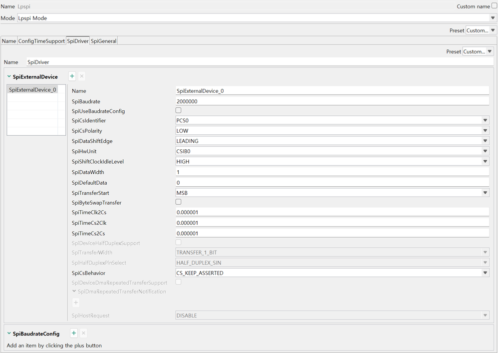

i am trying to use spi communication with BNO080 chip.
and i am using s32ds version 3.6, RTS is 4.0.0.
mcu is s32k314.
and i already watched spi examples, so you don't give examples please.
also, i have a s32k344 evb board(172 Pins)
1. would you check spi setting is right for using polling spi?
a)this is BNO spi Communication Spec.

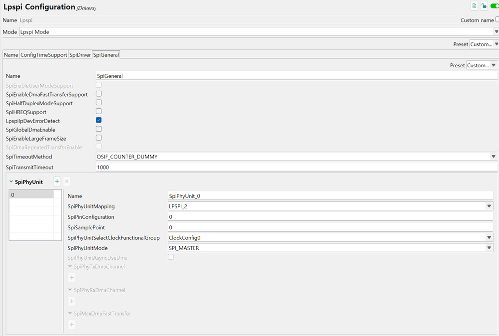

b) second picture is my spi configure. i am using spi2. cs pin is pcs0.

4. if i use interrupt spi function, how i set spi configure?
it is possible, would you show me pics for setting interrupt spi configure?
5. example has only polling and dma interrupt. if i use spi interrupt, i have to use dma?
also, it is possible, would you show me pics for setting interrupt spi configure?

1) SPI mode option (CPHA,CPOL) looks right, you should have SpiDataWidth = 8

4) After Lpspi_Ip_Init function is called, LPSPI_IP_POLLING mode is set as default. To change the default mode Lpspi_Ip_UpdateTransferMode should be called. INTC need to be set as well to enable SPI interrupt.
5) DMA is not needed for interrupt mode. You can refer to below example
https://community.nxp.com/t5/S32K-Knowledge-Base/Example-S32K312-SPI-Transmit-amp-Receive-Using-Inte...
