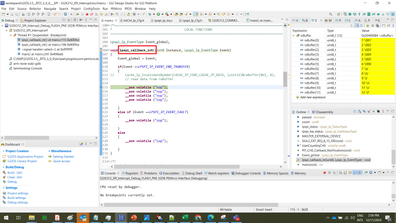

 The purpose of this demo application is to present a usage of the
 LPSPI IP Driver for the S32K3xx MCU.
 The example uses LPSPI2 for transmit & receive Twelve bytes using the SPI Interrupt Lpspi_Ip_AsyncTransmit() methodMOSI MISO connected on Hardware in loopback.
* Test HW: S32K3X2EVB-Q172
* MCU: S32K312
* Compiler: S32DS3.5
* SDK release: RTD 3.0.0
* Debugger: PE micro
* Target: internal_FLASH
Interrupt Triggered :--
Async callback triggered at the end of transfer/reception :--
Lpspi_Ip_AsyncTransmit(&MASTER_EXTERNAL_DEVICE, txBuffer, rxBuffer, numberOfBytes, lpspi_callback_int);
