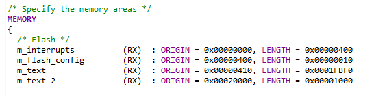

now , i have a problem ,i use S32K146 mcu and the S32DS IDE to development.
i want to place the function    "vExt_UART0_transmit(unsiged char* buff)" in a specified address (0x20000),
i try to use the command __attribute__((at(0x20000))),but it seem have no any effect.
can you help me ,my friend.

Seems like there is no other option with GCC.
1,952 Views
danielmartynek
Hi @oceansea,
Create a new section in the linker file starting at 0x20000
And declare the function with this attribute to put func into m_text_2:

oceansea
hi,
thank you reply.
it's a solusion to solve this;
but when the requirements become complex,for example
we have 3 function need specified addrss,
"vExt_UART0_transmit(unsiged char* buff)" in (0x20000),
"vExt_UART1_transmit(unsiged char* buff)" in (0x20100),
"vExt_UART2_transmit(unsiged char* buff)" in (0x20200);
Then we should create 3 new section in the linker file ,it maby have some complicated.
Is there a simpler way?
