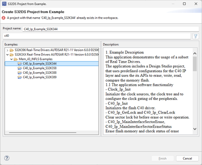

i have to develope a bootloader by low-level driver.
1. i included C40_IP. and do i need a Cache_IP driver for writing flash memory?
2. does s32k314 has a cache? so when i write data to flash memory, do i have to control cache memory?

1. & 2. Yes. It's better to manage the cache coherency so the CPU does not read stale data. You can refer to the C40_Ip_Example provided by the RTD package; it shows how to initialize the driver, clear the sectors before E/W, and reads the data.
Also, you can refer to chapter 4.1.55 (Parameter MemSynchronizeCache) from RTD_MEM_43_INFLS_UM.pdf (MCAL layer of C40_Ip driver):
...\S32DS\software\PlatformSDK_S32K3\RTD\Mem_43_INFLS_TS_T40D34M60I0R0\doc\

3. You can use C40_Ip (low-level driver) flash interface or Mem_Infls (MCAL driver) for flash operations. There is AN13388 which you can use as introduction.
4. You can refer to the S32K3 OTA demo under S32K3 Reference Software package. It can be downloaded by searching "Automotive SW - S32K3 - OTA Demo".
