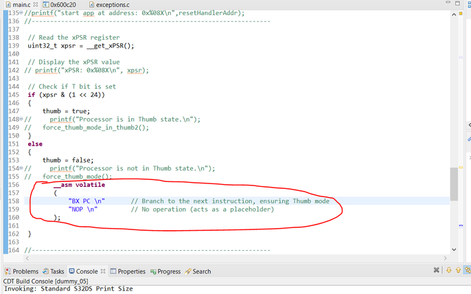

paulffffff
using this code:
Boot_JumpToApp(resetHandlerAddr);
Reset_Handler();
caused "HardFault_Handler".
debugger message at this point:
"UsageFault: An instruction executed with an invalid EPSR.T or EPSR.IT field.
HardFault: A fault has been escalated to a hard fault."
that is the reason, why I check "thumb" mode and force switch to it.
removing :
// force_thumb_mode();
    __asm volatile
        "BX PC \n"       // Branch to the next instruction, ensuring Thumb mode
        "NOP \n"         // No operation (acts as a placeholder)
does not change hard fault.
1,501 Views
Senlent
Hi@paulffffff
I don't understand why you use the "BX" instruction here when you have already ported the "Boot_JumpToApp" function to your project.
The reason for the hardfault comes from here.
For the specific reason, please refer to this answer.
