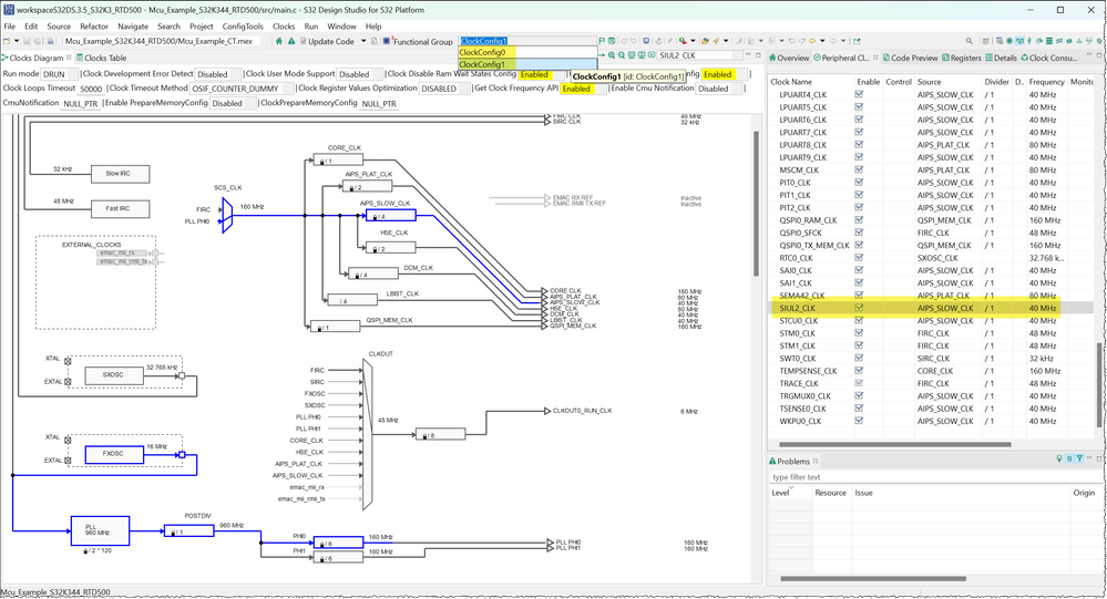

on s32k324, when we change clock settings from 160Mhz PLL to 48Mhz FIRC, the GPIO does not work anymore.(all gpio, not any specific pin)
we use RTD MCAL API
Mcu_InitClock(), to change the clock settings.
But after we change from PLL top FIRC, we found if we read GPIO pins, they always return high even the HW is low.
Any suggestions?
2 回复数
430 次查看
Robin_Shen
There is RTD example Mcu_Example_S32K344 which switch clock settings by Mcu_InitClock API. Have you test it?
Did you enable the clock of SIUL2 in Clocks Tool?
If it still doesn't work, please send me a simplified test project.
Robin
- If this post answers your question, please click the "ACCEPT AS SOLUTION" button. Thank you!
266 次查看
pasa_kevin_y
We found we have to call Mcu_Init()
