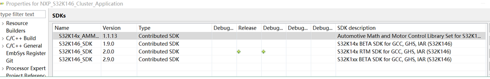

I have some problems in S32K 146 ftm pwm mode,
when I used FTM mode,I used FTM3 mode ,but all the FTM clock source are opend ,then I turn off the extra clock source of FTM and use PE to generate code and save it .    And the second time when I opened the project ,all the FTM clock has been opened again, I don't know why .  Could you help me ?

Hi,  Daniel,
   I use s32k146_SDK   2.0.0
All of my  projects behave like this in s32k146.

Hi Liu,
Thank you, I can reproduce the issue with SDK RTM 2.0.0.
But it works with SDK RTM 3.0.0.
I will try to find more information about it.

2684743015
Hi, Daniel,
   Thank you for your help,  my  colleague  has same problem with  SDK RTM 3.0.0.
BR, LiuChao

Hello LiuChao,
Sorry for the confusion, the issue has been already fixed but with the SDK v3.0.1 release.

HI Liu,
I can't reproduce this with the up-to-date S32DS.
What version of the S32DS are you using?
Is this an issue of a single project or all you projects behave like this?
