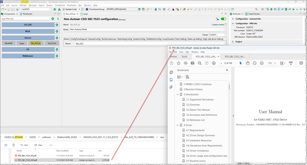

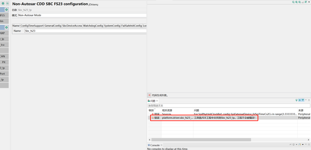

The examples in S32K3xx_SBC_FS23_R21-11_1.0.0_DS_updatesite_D2402.zip all seem to be based on HLD. How can I reproduce the error of Non-Autosar Sbc_fs23_Ip in your screenshot?
8,576件の閲覧回数
fengba_360
In my S32K312 project, I added the FS23, which might be the reason causing the issue. Can you guide me on how to use this driver, as shown in my previous screenshot?微信图片_20241105112149.png微信图片_20241105112149.png

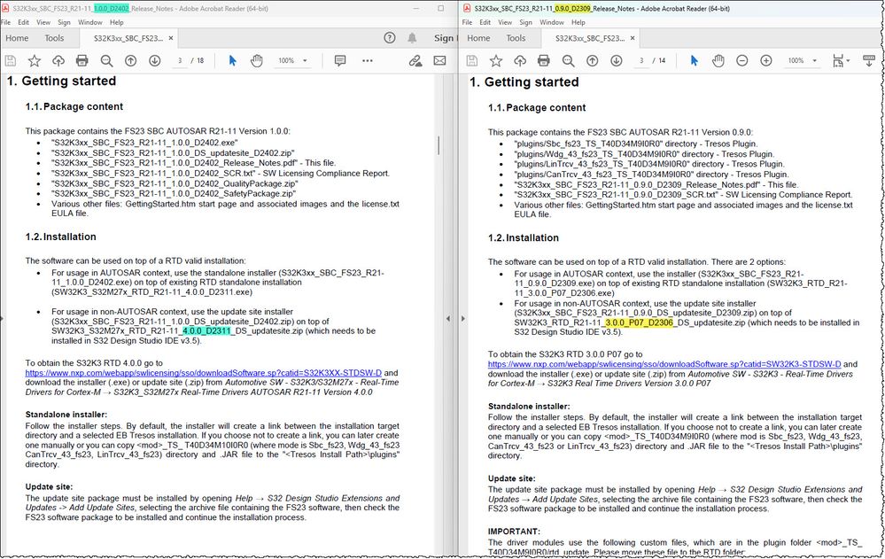

Please install the matching S32K3 RTD version according to the release note of the FS23 software driver.
If you are using S32K3 RTD 3.0.0 P07, then it is recommended to use S32K3xx FS23 SBC AUTOSAR R21-11 Version 0.9.0
If you want to use FS23 SBC AUTOSAR R21-11 Version 1.0.0, you may need to install a new S32DS v3.5 (such as S32DS.3.5_RTD400) and install S32K3 RTD 4.0.0.

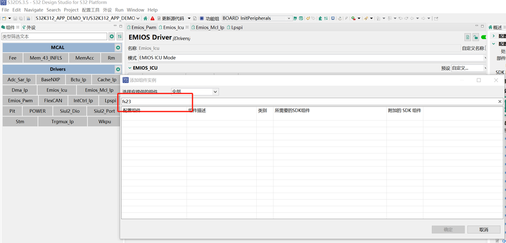

to be precise, I haven't found the components for fs23. Could you please guide me again?10.png10.png

I installed S32K3xx FS23 SBC AUTOSAR R21-11 Version 0.9.0 on S32K3 RTD 3.0.0 P07(C:\NXP\S32DS.3.5_RTD300P07) today. Strangely, I could not find the Non-AUTOSAR Sbc_fs23_Ip.
But after installing FS23 SBC AUTOSAR R21-11 Version 1.0.0 on S32K3 RTD 4.0.0(C:\NXP\S32DS.3.5_RTD400), I could see the Non-AUTOSAR component Sbc_fs23_Ip.
If you insist on using the Non-AUTOSAR Sbc_fs23_Ip, then I recommend using this newer version.
It is recommended to take a look at RTD_SBC_FS23_UM.pdf and RTD_SBC_FS23_IM.pdf:
C:\NXP\S32DS.3.5_RTD400\S32DS\software\PlatformSDK_S32K3\SW32K3_FS23_R21-11_1.0.0_D2312\Sbc_fs23_TS_T40D34M10I0R0\doc
Sbc_fs23_Ip S32K3 RTD 4.0.0 RTD_SBC_FS23_UM RTD_SBC_FS23_IM.pngSbc_fs23_Ip S32K3 RTD 4.0.0 RTD_SBC_FS23_UM RTD_SBC_FS23_IM.png

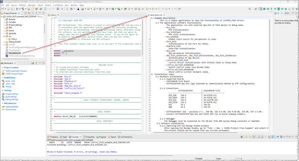

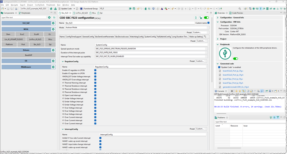

Unfortunately, our examples are all based on AUTOSAR MCAL, so when you import the fs23 examples, you will see that these projects do not use Sbc_fs23_Ip, but use MCAL components such as Sbc_fs23 and LinTrcv_43_fs23.
LinTrcv_fs23_example_HLD_S32K344 description.pngLinTrcv_fs23_example_HLD_S32K344 description.pngLinTrcv_fs23_example_HLD_S32K344 Sbc_fs23 LinTrcv_43_fs23.pngLinTrcv_fs23_example_HLD_S32K344 Sbc_fs23 LinTrcv_43_fs23.png

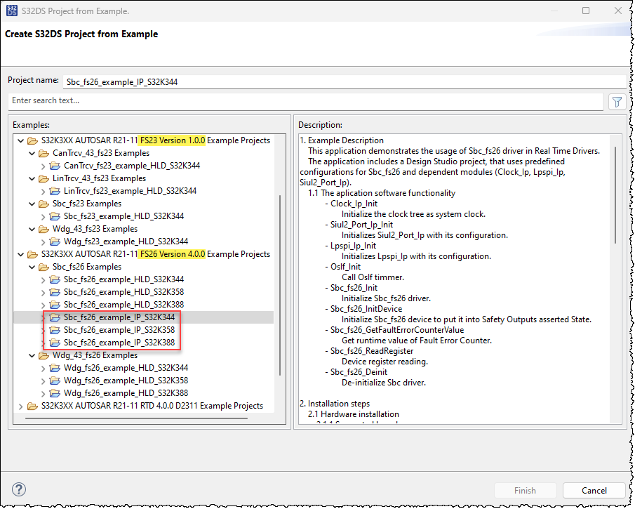

I tried to install SBC FS26 R21-11 4.0.0 on S32K3 RTD 4.0.0(C:\NXP\S32DS.3.5_RTD400). Although I can see the Non-AUTOSAR Sbc_fs26_example_IP_S32K344, I can no longer use the Sbc_fs23_Ip of FS23 SBC AUTOSAR R21-11 Version 1.0.0.Sorry for the confusion. Please wait for me to consult the FS23 software team to see if there is an example based on the Non-AUTOSAR Sbc_fs23_Ip.
Sbc_fs26_example_IP_S32K344 SBC FS26 R21-11 4.0.0.pngSbc_fs26_example_IP_S32K344 SBC FS26 R21-11 4.0.0.png

1.  The IP component of FS23 is not available in 0.9.0 package, it's recommended to use FS23 1.0.0 + RTD 4.0.0. I also tried to install FS23 1.0.0 on top of RTD 3.0.0 P07, it's not fully compatible but I can support it with a workaround solution so that we can still enable the integration.
2. The example for FS23 IP was not provided inside the package, please let me know more details about your hardware setup, then I can help you to create the suitable example.
3. I think it was a problem with either FS23 or FS26 update site, we are investigating and will let you know soon.

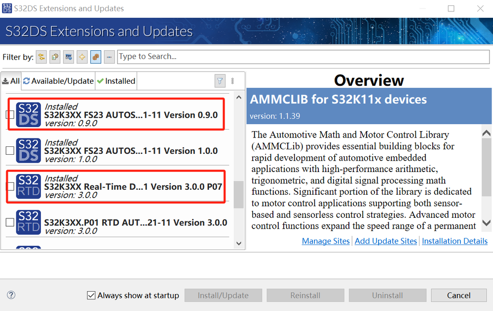

Sorry for the late reply. I tried to download and install the two SDKs: S32K3XXFS23 AUTOS…1-11 Version 0.9.0 and S32K3XX Real-Time D…1 Version 3.0.0 P07. However, I am still encountering the following errors when using them. What additional steps do I need to take to integrate these two SDKs or resolve the issues? Please provide more guidance.7FS23.png7FS23.png8FS23.png8FS23.png

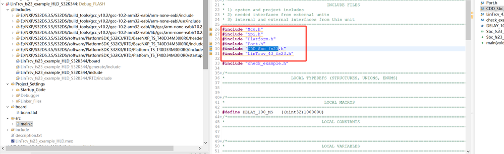

I imported the example routines, but I didn't find any useful library functions or examples.
I'm not sure if I'm using it the right way. Please have a look. Sorry for any inconvenience caused.
