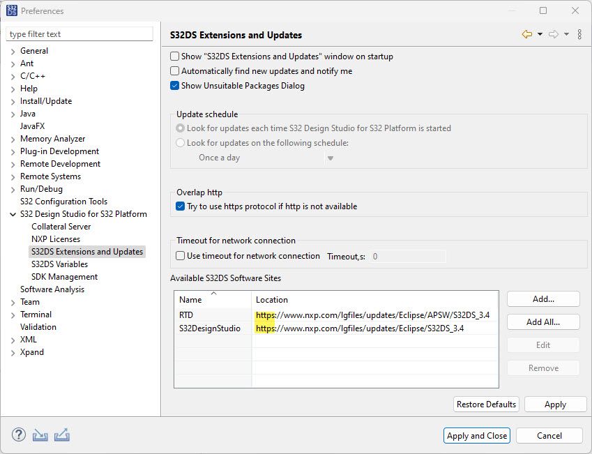

When I install the extension"S32SDK S32K1XX RTM4.0.3"online,it says"Operation detailsSoftware being installed: com.nxp.s32ds.s32k1.dev.feature.feature.group 1.0.0.202106101451 Missing requirement: com.nxp.s32ds.s32k1.dev.feature.feature.group 1.0.0.202106101451 requires 'org.eclipse.equinox.p2.iu; com.nxp.s32ds.cle.s32k1.s32k142w.dev.feature.feature.group [1.0.0.202106101446,1.0.0.202106101446]' but it could not be found".The screenshot is below.

Hi @michaelcr97 and @rereli ,
Sorry for the inconvenience we bring you!
it is recommended to change Available S32DS Software Sites to https. This has been discussed in Where can I find it?S32_SDK_S32K1xx_RTM_4.0.3.

Robin_Shen

rereli
it is useful! thanks very much

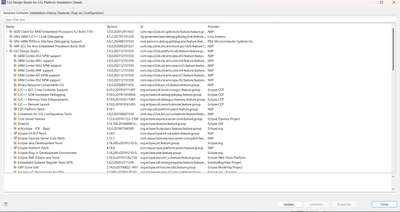

Actually in my case, if I go to help->installation details-> and I expand S32Design Studio I will find that eclipse requirments market with a red "x", seems those were not installed. I attached a picture:
14,641件の閲覧回数
rereli
Where is the red X.Is it?But i think it is a red + hahahah~
