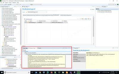

Hi All, I want to know ,Why this red cross or error showing on module heading. I faced same issue for few module.
Where i can find ,Why it happen.
Please guide,If any one knows

The red cross/error represents a invalid configuration and you need to correct it. You can see this error details in the Problems View box
