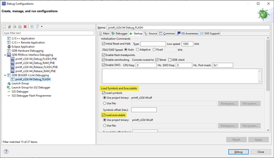

Hi, I program S32K144 0x400 caused secure mode, and then low RST. But bebug still failed, and the console shows:

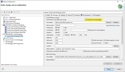

Hi @shiliwu,
The error log indicates that the application that is running in the target device is doing/setting something so the J-Link can't access that memory area anymore.
As you mentioned, it could be some memory read protection. Could you share your debug configurations?
Also, just keep in mind the following note from the program partition section from the S32K1XX's reference manual:
Once Flash Keys DBG_CHAL & DBG_AUTH commands must be run and pass.
Julián
