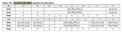

Using s32k312 chip to control sbc fs23.
I want to use the built-in CAN transceiver in NXP's SBC FS23 to send CAN messages. Use SPI communication to initialize the registers of fs23, and then set the registers related to the CAN transceiver.
txp_camel_0-1715061042536.pngThe value of this register is 0x3f08(can enable)
txp_camel_1-1715061186244.pngThe value of this register is 0x02a0(
CAN Transceiver active mode)
txp_camel_2-1715061294167.pngThe value of this register is 0x308f(Strangely, SBC is in both normal and init states)
txp_camel_3-1715061430404.pngThe value of this register is 0x061f(Can state machine in normal mode)
For debugging convenience, I connected the debug pin of sbc fs23 to a voltage of 3.8V.
M_SYS1_CFG reg is 0x8(sbc in debug mode)
Above is my register settings,But when sending can messages, can remains in a busy state.
