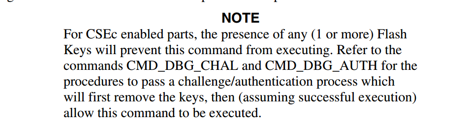

814420552
hello Daniel
      as above describe, first must remove  keys,  but how can i know are there keys? is there a register for me to check whether enabled CESc and key size ,after this call commands CMD_DBG_CHAL and CMD_DBG_AUTH

I used this procedure during testing of CSE: anytime I had some troubles, I tried to do mass erase. I usually use Lauterbach debugger, so I tried flash.UNSECUREerase command. If whole flash was erased, I could start over. If not, it meant that I need to use CMD_DBG_HAL and CMD_DBG_AUTH commands to reset the partition/CSE. If this doesn't work too, then there's last option - MASTER_ECU_KEY is missing, so it's necessary to load it and then run the command to reset partition. With this approach, I was always able to get back to start point. Notice that you need to know MASTER_ECU_KEY otherwise you won't be able to execute CMD_DBG_AUTH.

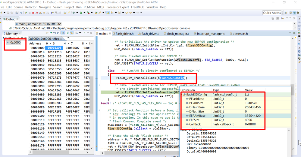

814420552
hello
      why call FLASH_DRV_EraseAllBlock API can't erase the data in 0x6000?

814420552
<1>so the result is only use  Erase All Blocks command  to remove the partition and erase PFlash and FlexNVM and IFR?
<2>if has no EEPROM partition ,we can use Erase Blocks command  to erase flexNVM no erase PFlash?
is it right for my understanding?

danielmartynek
Hi Kui,
Yes, correct.
1. Erase All Blocks, Erase All Blocks Unsecure, External mass-erase.
2. The DFlash block can be erase by the Erase Flash Block if the FlexNVM is configured for DFlash only.
In addition, the CSEc command can be used (as discussed in the thread above) to remove the partitioning, but this would required to have the CSEc keys stored first.
