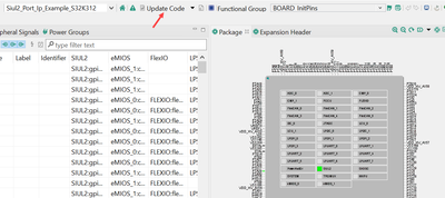

Hi NXP team,
I have configured PTA14 as ADC_1, but  Siul2_Port_Ip_Cfg.c doesn't have generated code.
        .base                        = IP_SIUL2,
        .pinPortIdx                  = 12u,
        .mux                         = PORT_MUX_ALT3,
        .safeMode                    = PORT_SAFE_MODE_DISABLED,
        .inputFilter                 = PORT_INPUT_FILTER_DISABLED,
        .pullConfig                  = PORT_INTERNAL_PULL_NOT_ENABLED,
        .pullKeep                    = PORT_PULL_KEEP_DISABLED,
        .invert                      = PORT_INVERT_DISABLED,
        .inputBuffer                 = PORT_INPUT_BUFFER_ENABLED,
        .outputBuffer                = PORT_OUTPUT_BUFFER_DISABLED,
        .adcInterleaves              = { MUX_MODE_NOT_AVAILABLE, MUX_MODE_NOT_AVAILABLE },
        .inputMuxReg                 = {
                                         1u

Hi @gumu
You are correct, the pins that are labeled as default in Config Tools it does not appear in the pin configuration structure since technically it would be making a double configuration of the same functionality.

VaneB
Hi @gumu
Did you update the code once you finish the changes on ConfigTools?
B.R.
VaneB
2,649 Views
gumu
Contributor V
Hi @VaneB ,
Yes, I clicked 'update code'.
PIN module is not able to generate code for these pins which are routed as default .
PTA14 is routed to ADC as default
Is it right?
2,631 Views
VaneB
Hi @gumu
