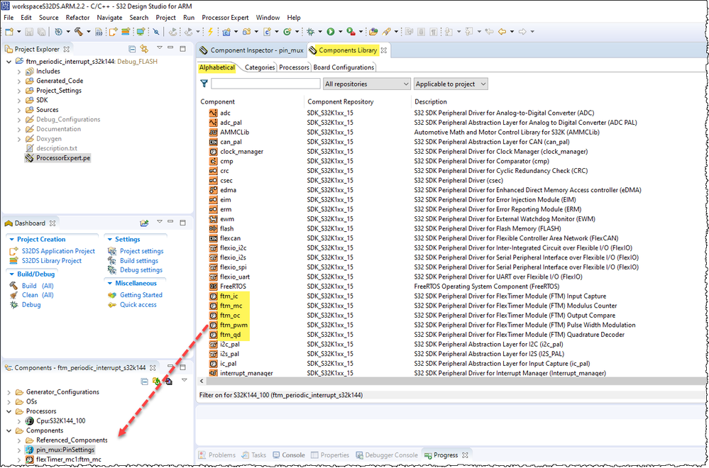

Today I want to use FTM, but I can't find the FTM component. It's strange that the routine has FTM, but I can't find the FTM component where the routine adds components

Hi kalajiao,
You can press the left button of mouse and drag to the project.

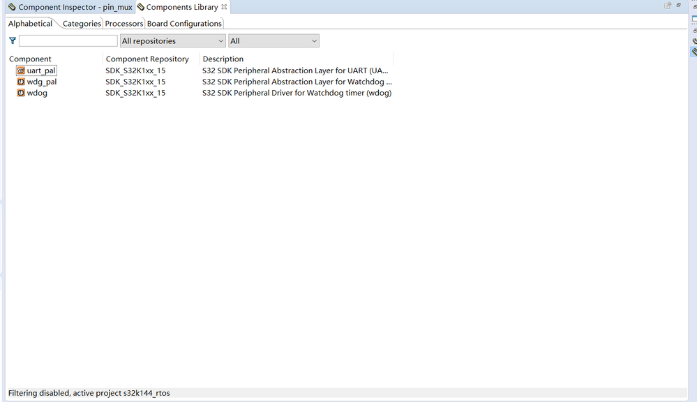

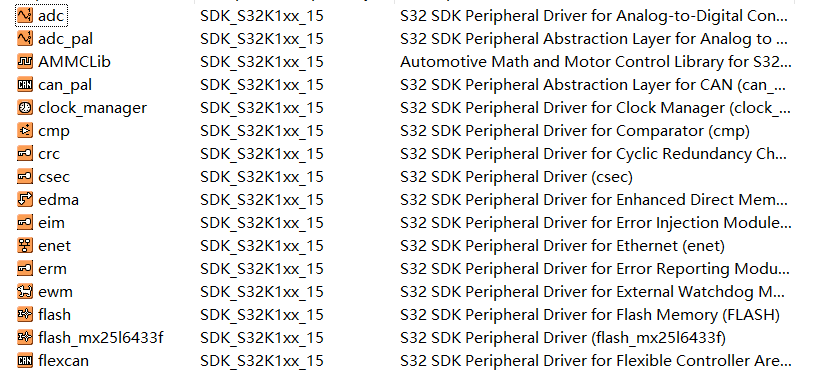

kalajiao
I mean I was in there didn't find, but oddly I copy routines FTM components to the project and then re-open the software not only has the FTM components, after more than a lot of other components before, a little strange, every time, do not want to be my lack of component to open software luck, met after so wanted to ask how to solve?

kalajiao
Today, I want to add an I2C component, but IT happened again. This time I remember the screenshot, this is what I said last time, but this time it looks more serious, I will restart the software to try
