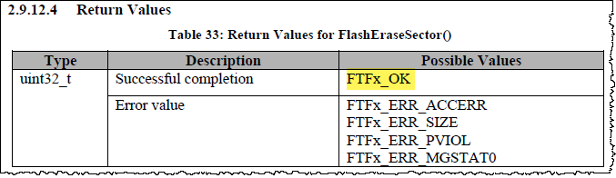

Robin_Shen
Could you try waiting for FlashEraseSector to return FTFx_OK? It seems to be caused by too little waiting time.
Robin
