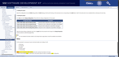

Julián_AragónM
Hi @ash123456789,
There are many examples in the SDK which use a different clock source. For example, the "power_mode_switch_s32k144" uses SIRC:
Julián
