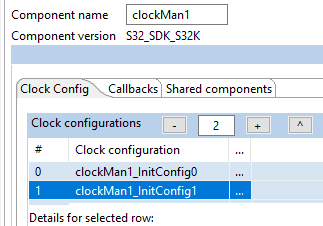

However, the SDK 3.0.0 Processor Expert allows creating more clock configurations.
The system clock can be updated using CLOCK_SYS_UpdateConfiguration().
