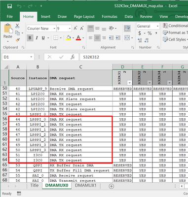

kalvin
I also used DMAMUX @davidtosenovjan .
static void DMAMUX_Init(LPSPI_Type *Instance,uint8_t rxch,uint8_t txch)
uint32_t DMA_CH_RX_MUX_NUM = 0;
if(Instance == LPSPI0) DMA_CH_RX_MUX_NUM = 14;                                //using LPSPI0
if(Instance == LPSPI1) DMA_CH_RX_MUX_NUM = 16;
if(Instance == LPSPI2) DMA_CH_RX_MUX_NUM = 18;
SIM->PLATCGC |= SIM_PLATCGC_CGCDMA(1);
PCC->PCCn[PCC_DMAMUX_INDEX] |= PCC_PCCn_CGC_MASK;
/* DMA Channel 4 for LPSPI RX */
DMAMUX->CHCFG[rxch] &= ~ DMAMUX_CHCFG_ENBL(1);
DMAMUX->CHCFG[rxch] |= DMAMUX_CHCFG_SOURCE(DMA_CH_RX_MUX_NUM); //14
DMAMUX->CHCFG[rxch] |= DMAMUX_CHCFG_ENBL(1);
/* DMA Channel 5 for LPSPI TX */
DMAMUX->CHCFG[txch] &= ~ DMAMUX_CHCFG_ENBL(1);
DMAMUX->CHCFG[txch] |= DMAMUX_CHCFG_SOURCE(DMA_CH_RX_MUX_NUM+1); //14+1
DMAMUX->CHCFG[txch] |= DMAMUX_CHCFG_ENBL(1);
