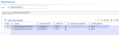

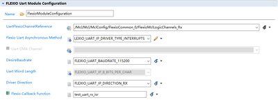

The configuration in the MCL is here:

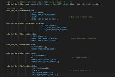

I find that if i shield someplace, I will get the completely right data:
But I still don't know the real reason. I guess maybe there is something to do with the shift register and timer's configurations and also with the work timing. Could you please explain it more clear?
Thanks!

The configuration file I mentioned is .xdm files in EB Tresos that you configure for Uart and MCL modules

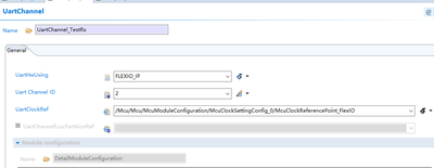

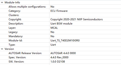

I use S32K144 mcu, and the EB's version is 26.0.1. There is some information I can get from the sw uart module:

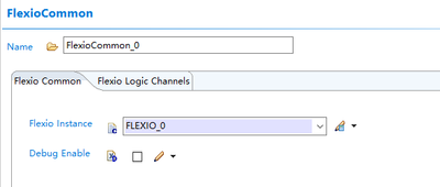

But a embarrassing thing is that I don't know how to insert the .xdm files. There are some screenshots I hope it useful:
mcl:
uart rx:
Uart Tx is almost the same as the uart Rx.

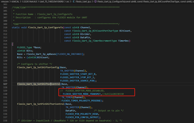

Emmmm, I just remember something else. When I use the tx function, it didn't work until I modified a line of code as the follow:

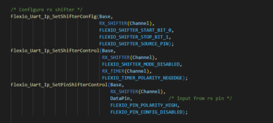

About the Tx's problem, I found that there's nowhere that could enable the shifter's transmit mode in the code. So I modified the shifter's initialization configuration, and then it worked.

2. Why you need to modify Flexio_Uart_Ip_ConfigureTx() as it set FLEXIO_SHIFTER_MODE_TRANSMIT by default in our release source code?

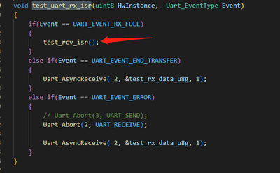

1, I've  defined "test_uart_rx_isr" as the rx_call_back func, and the usage is as the picture:
Each byte is processed in the func "test_rev_isr" which means that I would process the rx byte every time it came in by the event "UART_EVENT_RX_FULL",
and then started the next rx at the time of "UART_EVENT_END_TRANSFER".
2. I guess maybe there was some kind of accident or something else when generating configuration code by EB tresos which resulted in that I didn't get FLEXIO_SHIFTER_MODE_TRANSMIT in the Flexio_Uart_Ip_ConfigureTx(). That was set disable. At first time I didn't know what happened and why there was no  one byte transmited. After I read almost all the code for flexio uart function in MCL, I considered maybe I should try to modified it, and then I got it. It's really a painful experience...

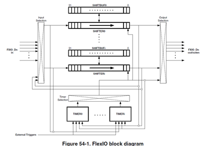

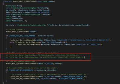

Your behavior with FlexIO is normal, because that FlexIO is using Shifter and Timer to receive data.
If your message is continuously, at the time Shifter and Timer are disabled by Flexio_Uart_Ip_StopTransfer(), 2nd byte comes then FlexIO cannot receive it.
But LpUart is different, as in Lpuart it has Data buffer to hold data incoming. So when Interrupt of 1st byte is in progress, 2nd byte would be store in Data buffer, and Lpuart wouldn't miss it.
My suggestion to use Uart_AsyncReceive for both instance Lpuart and FlexIO is specify BufferSize to be received. Then you will not miss characters like your behavior.
