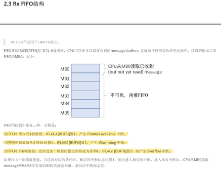

Hello, i use the S32k118 chip. and use the Standard Can.
i'm in trouble in the program.I use CANOE to send 10 message,and set period to one 20ms and others are 100ms.But i found it may lost the message.Could you help me or offer some information?
First,i took some configuration in flexcan,like set MCR[RFEN] = 0x01,
So the Rx FIFO table:MB 0-9:
1.MBs 0~5 is used by the reception FIFO engine.in MB0,it will save the ID and data,but i see the MB1~5 is reserved.i don't what it mean.i think this area(MB1~5) is to save the message when many frame come in same time.do you agree?
2.MBs 6~9 is used to save the RX ID,so the maximum number of RX message is16. right?

Hi@xiaobaby22
For details you need to read the datasheet and briefly answer your question as below.

对,我确实看到MB0里面保存着一帧未读的数据。但是当FIFO中有4,5帧的时候。这个未读得数据放在哪啊?是不是放在MB1~MB5中,只是我们用户不可见啊?

Hi@xiaobaby22
MB0~MB5既然作为了FIFO引擎使用,那么它的结构可能并不是和MB的存储结构一致,不过多余的帧肯定是存在FIFO引擎中的。
