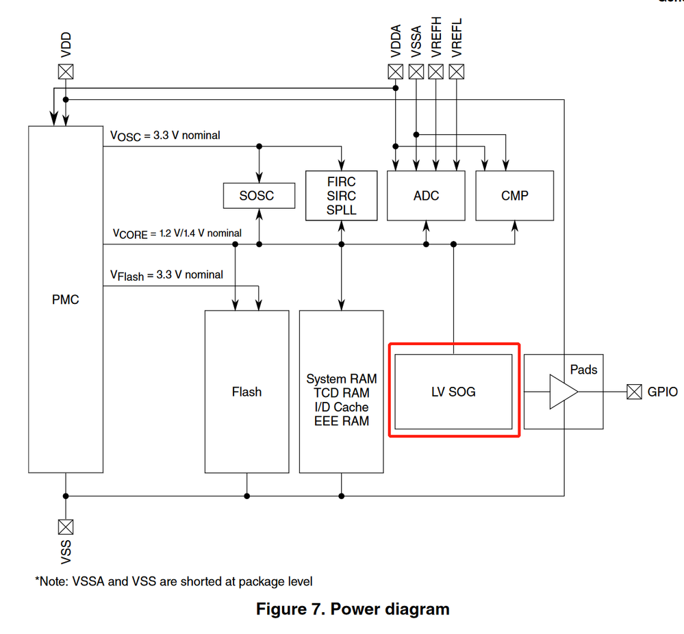

What does LV SOG mean?

Hi@PYGC
I found some descriptions, I guess it should mean the following.
LV SOG->Low Voltage Sea-Of-Gates

Hi@PYGC
Can you elaborate on which file this image comes from?
2,027 Views
PYGC
S32K1xx Data Sheet Rev.14
4.4 Power and ground pins
Figure 7. Power diagram

PYGC
Thank you very much!
