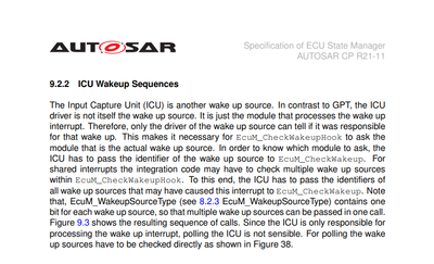

1. As you already know, Icu module doesn't provide functions that can check wakeup source directly at the MCAL layer. Icu will transfer wakeup source information to EcuM module, and this module will check wakeup source. In RTD driver, EcuM is a stub module, intention is to use them as a reference and can be modified/replaced depending on the application needs.
You can follow Specification of ECU State Manager:

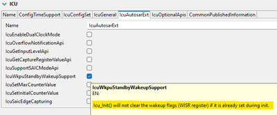

2. In Icu configuration, when user enable "IcuWkpuStandbyWakeSupport" then Icu_Init() will not clear WISR flags.
In your project, to check wakeup source in the Wkpu_Ip layer, you can refer to the below code:
When call Platform_Init(NULL_PTR); before Icu_Init(), I saw that somehow the WISR flags were erased. So, I called this function after Icu_Init() function.

EcuM_CheckWakeup is being called from Icu_ReportwakeupAndOverFlow ICU driver.
Since Icu_ReportwakeupAndOverFlow  have condtion checking for variable Icu_CuurentMode to ICU_MODE_SLEEP macro.

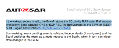

The way I see it, there are two options:
1. Call EcuM_Checkwakeup() after Standby exit, but before EcuM state machine moves to RUN. This will process the wakeup sources during standby. If the wakeup source is valid, ECU is returned to RUN state.
This is found in the Specification of ECU State Manager:
2. Call it through ISR context, which will service the wakeup source immediately.
