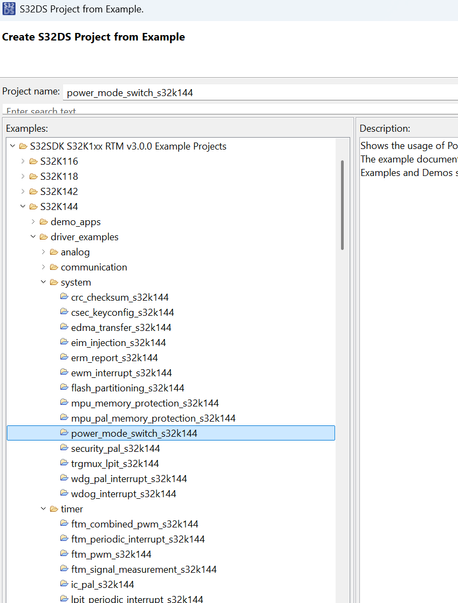

S32 Design Studio (S32DS) v2.2 for ARM is compatible with SDK v3.0.0 (released February 28, 2019).
Please note that this is legacy software - is not recommended for new designs and we don't support it
However, SDK v3.0.0 includes an example demonstrating the transition to VLSP/VLSR and STOP low-power modes.

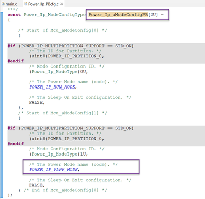

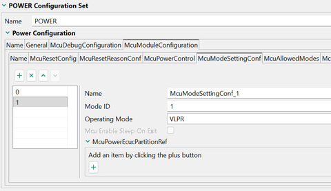

In S3DS 3.6 install RTD 3.0.0, there is this example:
Power_Ip_Example_S32K144
You can add another power mode in the Power_Ip driver for VLPR:
Generate the code:
Use this function to change the MCU mode from RUN to VLPR and back:
Power_Ip_SetMode(&Power_Ip_aModeConfigPB[0]);
Power_Ip_SetMode(&Power_Ip_aModeConfigPB[1]);

The controller I am using is the S32K144, and the interface I am using is S32DS for ARM. The interface you suggested in your previous response was S32DS for the S32 platform. I want the correct settings for S32DS for ARM. I also use Processor Expert to configure the settings.
1,920件の閲覧回数
danielmartynek
Hi @adem_marangoz,
For current development on S32K144, use S32DS for S32 Platforms v3.6 and up-to-date RTD drivers version 3.0.0 - this what I showed in my last reply.
