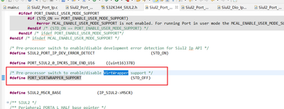

when i config siul2 gpio, i met a question.
I donnot know the mean of VirtWrapper.
What function does it have?
When do i need to Config it?

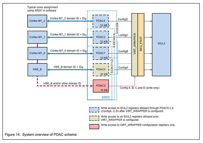

davidtosenovjan
This needs to be used in case you need IO signal assigned for specific cores. It is advanced protection method.
