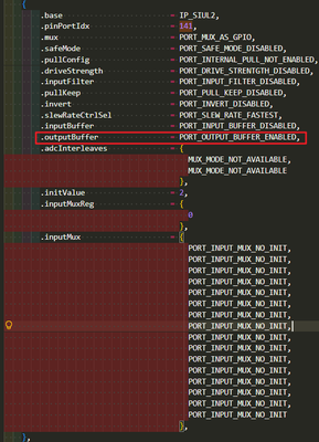

Actually this is the main reason I asked this question, following code will be generated when I configure PTE13 PinMode as PG_VRC_CTRL_OUT in MCAL Port module.
#define SIUL2_0_PORT141_PG_VRC_CTRL_OUT (PORT_ONLY_OUTPUT_MODE)
Port_Ipw_SetOnlyOutputMode() will be called and “OBE” bit will set in this function.​
I think it maybe a MCAL bug, PG_VRC_CTRL_OUT mode enables OBE by mistake.
Could you please help to check?
Do you think that configuring it to GPIO + PORT_PIN_HIGH_Z + PORT_PIN_LEVEL_NOTCHANGE can be a workaround, in this case, MSCR141 of PTE13 can be guaranteed to be 0 (OBE = 0)?

24件の閲覧回数
PavelL
Hello @kumamon ,
I now understand your concern. Your configuration selects:
  • Pin Direction = PORT_PIN_HIGH_Z
  • Pin Level Value = PORT_PIN_LEVEL_NOTCHANGED
  • Pin Mode = PG_VRC_CTRL_OUT
Therefore, the digital output buffer is not expected to be enabled. If the generated code nevertheless sets OBE = 1, this behavior should be investigated in the MCAL Port configuration.
Please note that MSCR141 is documented as not supported for this special-purpose direct signal. PTE13/VRC_CTRL is controlled by the PMC and should not require a normal SIUL2 output-buffer configuration. Accessing or modifying MSCR141 manually is therefore not a supported application method.
Could you please provide the exact MCAL/RTD version and the relevant generated configuration and initialization code that sets OBE? Also provide exact version of used S32K3 MCU.
Regarding the CPU workload, this was only an optional suggestion for observing the regulator response and is not required to verify the VRC_CTRL configuration.
Pavel

kumamon
Hello Pavel,
Thanks.
According to the following diagram, PTE13 is not necessarily VRC_CTRL, it can be any of other functions. I feel It is conflicting to the statement "MSCR141 is not supported".
RTD Version:
Configuration:
Generated:
Note: Sorry, I made a mistake in previous discussion. OBE is not set by Port_Ipw_SetOnlyOutputMode(), it shall be set in Siul2_Port_Ip_PinInit().
MCU: S32K322
Thanks.
BR/Kumamon
