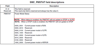

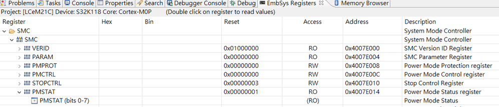

In order to verify whether the power mode has been switched, I access the memory address 0x4007E014, which is supposed to store the value of SMC->PMSTAT
However, I discovered only when I switched between RUN <-> VLPR, the value changed. RUN mode returned value 1, VLPR returned value 4, as described in `SMC_GetPowerModeStatus()` in power_smc_hw_access.h.
When I tried to switch to VLPS, the value always remained 1. This makes me wonder maybe the mode didn't change as expected, yet the function `POWER_SYS_SetMode()` returned "STATUS_SUCCESS".
Is the way I verify is wrong? Or there is something interfering during the transition?

I realized my mistake.
SMC->PMSTAT cannot reveal VLPS status when debug is enabled.
