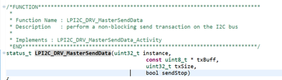

Hi@skb
    try to use this function.
Tips:
         Because in the blocking API function, the API function of the OSIF component-OSIF_SemaWait() is called to check the data transmission and reception semaphore in the peripheral driver global state structure, if RTOS is used in the application project, such as FreeRTOS , The task that calls the blocking API function will be blocked, and the CPU resources are released to run other ready high-priority thinking, until the receipt and delivery is completed (semaphore release) or timeout, so the CPU execution efficiency will be greatly improved; and if the application If RTOS is not used in the project, the blocking API function will always occupy the CPU, resulting in a waste of CPU resources;
         In summary, if the application project uses RTOS, it is recommended to use the blocking API function; if the application project does not use the RTOS, it is recommended to use the non-blocking API function, and cooperate with the interrupt callback function to determine the data receiving and sending status and do corresponding processing.
BR!
