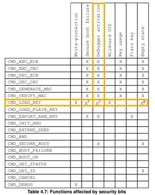

In our company we are working on a project having an S32K1xx microcontroller, using the CSEc module.
We would like to update one of the SHE-keys. All of them have the DEBUG_PROT flag set. The question is: is it possible to update the key via CMD_LOAD_KEY while a debugger is connected to the device?

According to the information we have, one of the functions affected by the security bits is CMD_LOAD_KEY, specifly is affected by the Write Protection Flag (WRITE_PROT), Boot Protection Flag (BOOT_PROT), Debugger Usage Protection Flag (DEBUG_PROT) and Wildcard Protection Flag (WILDCARD).
As far as we understand, you will not be able to update the Key when DEBUG_PROT is set.
Please refer to the following image.
