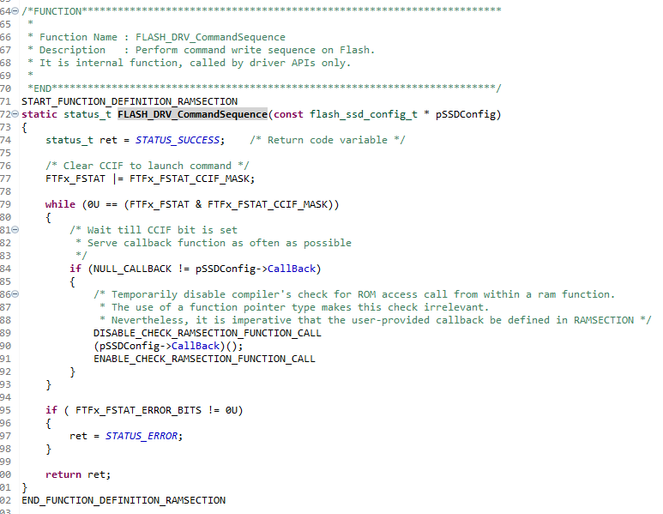

If the operation requires the driver to work from SRAM, the only function that has to be in SRAM is FLASH_DRV_CommandSequence(). This is a blocking function, it blocks the execution while CCIF = 0.
You did not specify the SDK version.
In SDK 4.0.1, the function is in SRAM by default.

Hi @qinxk,
The solution is that the APIs do not have to be in SRAM.
Only the function that clears CCIF and waits while CCIF = 0 has to be in SRAM.
And by default, it is in SRAM.

but I notice that this macro doesn't have value as follow,  how do you know it is in SRAM defautly?

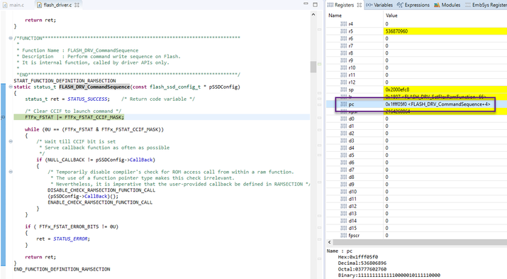

I'm testing the flash_partitioning_s32k146 example (SDK 4.0.3, gcc 6.2).
Debug_Flash target
The FLASH_DRV_CommandSequence() function is in SRAM (.code_ram).
BR, Daniel
2,016 Views
qinxk
Ok, from the debug info, it's really in SRAM.

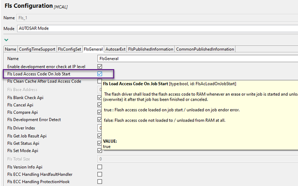

This is just a low-level SDK driver where one function is placed in SRAM, if you need the APIs to be in SRAM, you need to place it there yourself, like the FLASH_DRV_CommandSequence() is, for example.
You may use the Autosar MCAL RTD FSL driver, there is this option:
Again, if this is not what you mean, you would need to implement it yourself.
