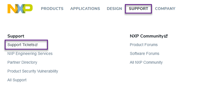

Could you please share the steps to create ticket.
26,882 Views
danielmartynek
@Sathishkumar_Rajkumar,
Go to nxp.com and login,
you should see Support Tickets as below.
Thank you,
BR, Daniel
