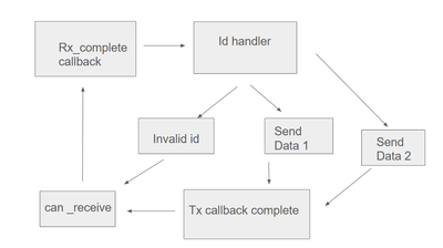

I am trying to convert my canbus code so that instead of transmitting data constantly using sendblocking it waits to receive a message and then sends out data based on the message received.

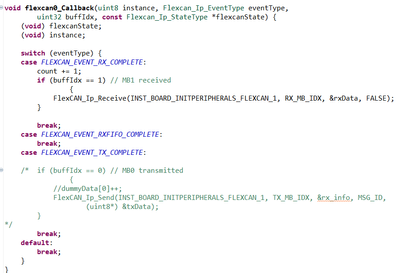

I have this sample callback data from elsewhere example code, and am trying to understand how to utilize it properly. As it is written in this example when it finishes a receive command and writes the frame into rxData, it will then raise the  "rx_complete" event and start another receive. Does this event still get raised even if the send/read returns an error/non success?
Similarly with sending, since the send would raise a tx complete callback it would then start an infinite loop of sending the same data over and over? as itd send, raise "tx_complete" then send again?
So to return to the original goal of transmitting specific data based on the id received, I would want to place a function call within the rx_complete event case that would handle the parsing of the id, send the data off, and in the tx callback for a completed send I would call a receive to wait for its next request? I made a very basic block diagram to illustrate the intention does this make sense for how to use the callback functions?
